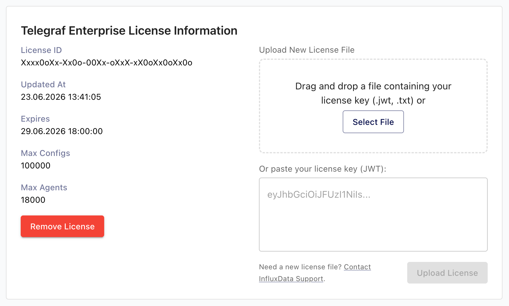

## View the current license
**In the UI**, navigate to **Settings \> Enterprise** to view:
* **License ID**: the unique identifier for your license. Include this
  value when contacting InfluxData support.
* **Loaded**: the date and time the license was applied to this
  Telegraf Controller instance.
* **Expires**: the contractual expiration date, with a status chip
  indicating current state (valid, expiring, or expired).
* **Max configurations**: the configurations entitlement from the license.
* **Max reporting agents**: the reporting agents entitlement from the
  license.
<img alt="Telegraf Enterprise license details in Telegraf Controller" src="/img/telegraf/controller-licensing-details-card.png" width="860">

## Replace a license
To apply a renewed or upgraded license, apply the new license through**Settings \> Enterprise** exactly the same way you[applied the first one](/telegraf/controller/telegraf-enterprise/apply-license/#apply-a-license-through-the-user-interface).
Telegraf Controller validates the new license and replaces the existing one
in place. The new entitlements take effect immediately with no restart.

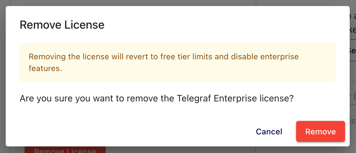

## Remove a license
Removing a license reverts Telegraf Controller to the free tier. Only the**Owner** can remove a license.
1. Navigate to **Settings \> Enterprise**.
2. Click **Remove license**.
3. Confirm the action in the dialog.
   <img src="/img/telegraf/controller-licensing-remove-confirm.png" width="621" alt="Confirm that you want to remove your Telegraf Enterprise license">
The change takes effect immediately, with no restart required.
