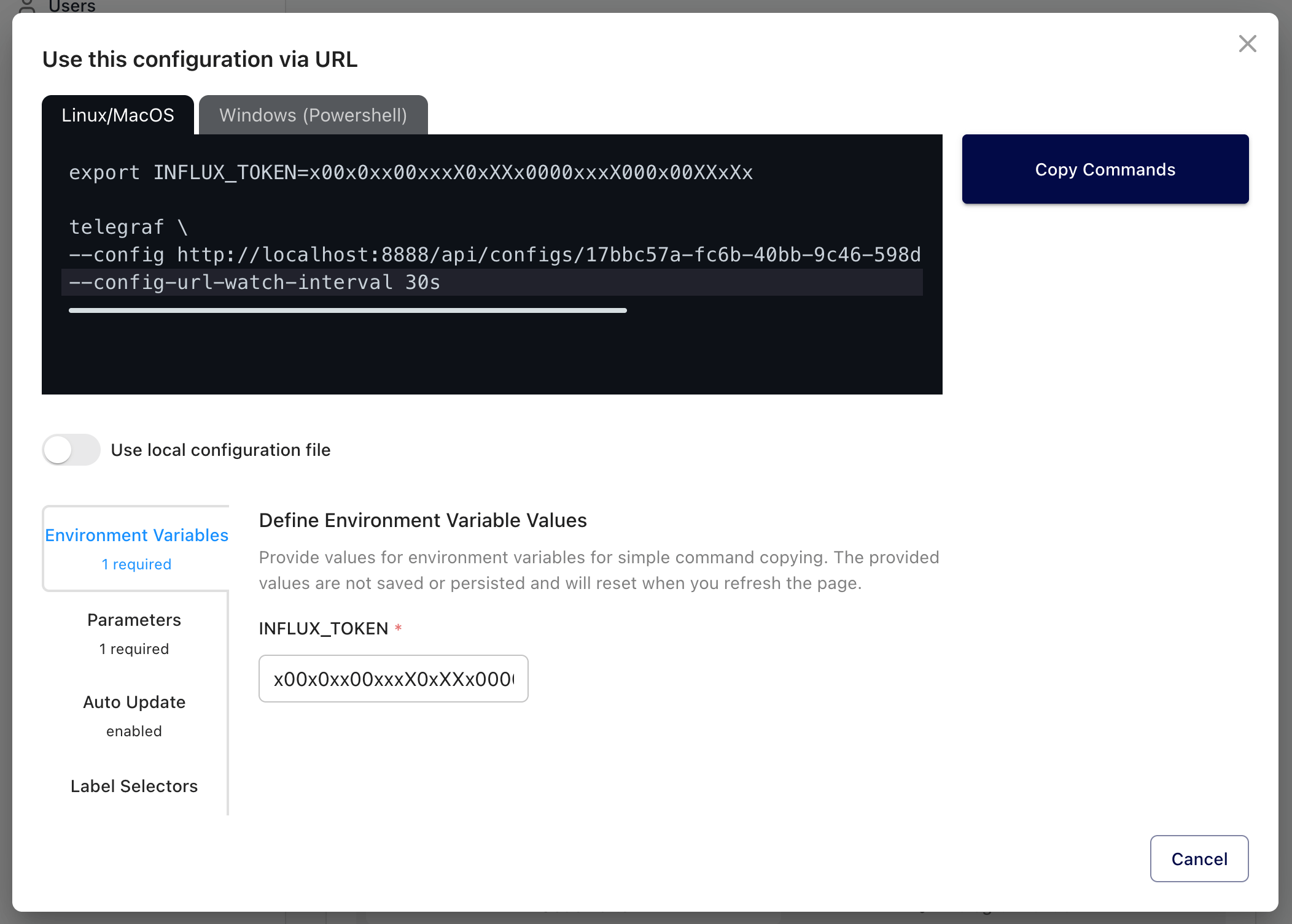

### Use the command builder
Telegraf Controller can build the `telegraf` command for you:
1. In Telegraf Controller, select **Configurations** in the navigation bar.
2. Click the name of the configuration you created.
3. Click **Use this Configuration**.
4. In the command builder modal:
   1. In the **Environment Variables** section, define the **INFLUX\_TOKEN**environment variable using the raw token string of the API token you
      created. This authorizes the Telegraf agent to interact with
      Telegraf Controller.
   2. In the **Parameters** section, define the **agent\_id** parameter with
      a unique agent identifier.
   3. In the **Auto Update** section, enable auto-update and set the interval
      to `30s`. This instructs Telegraf to check for configuration updates
      every 30 seconds.
   <img src="/img/telegraf/controller-gs-command-builder.png" width="1052" alt="Telegraf Controller Command Builder">
5. Click **Copy Commands** to copy the generated command to your clipboard.
6. Paste and run the command in your terminal.
