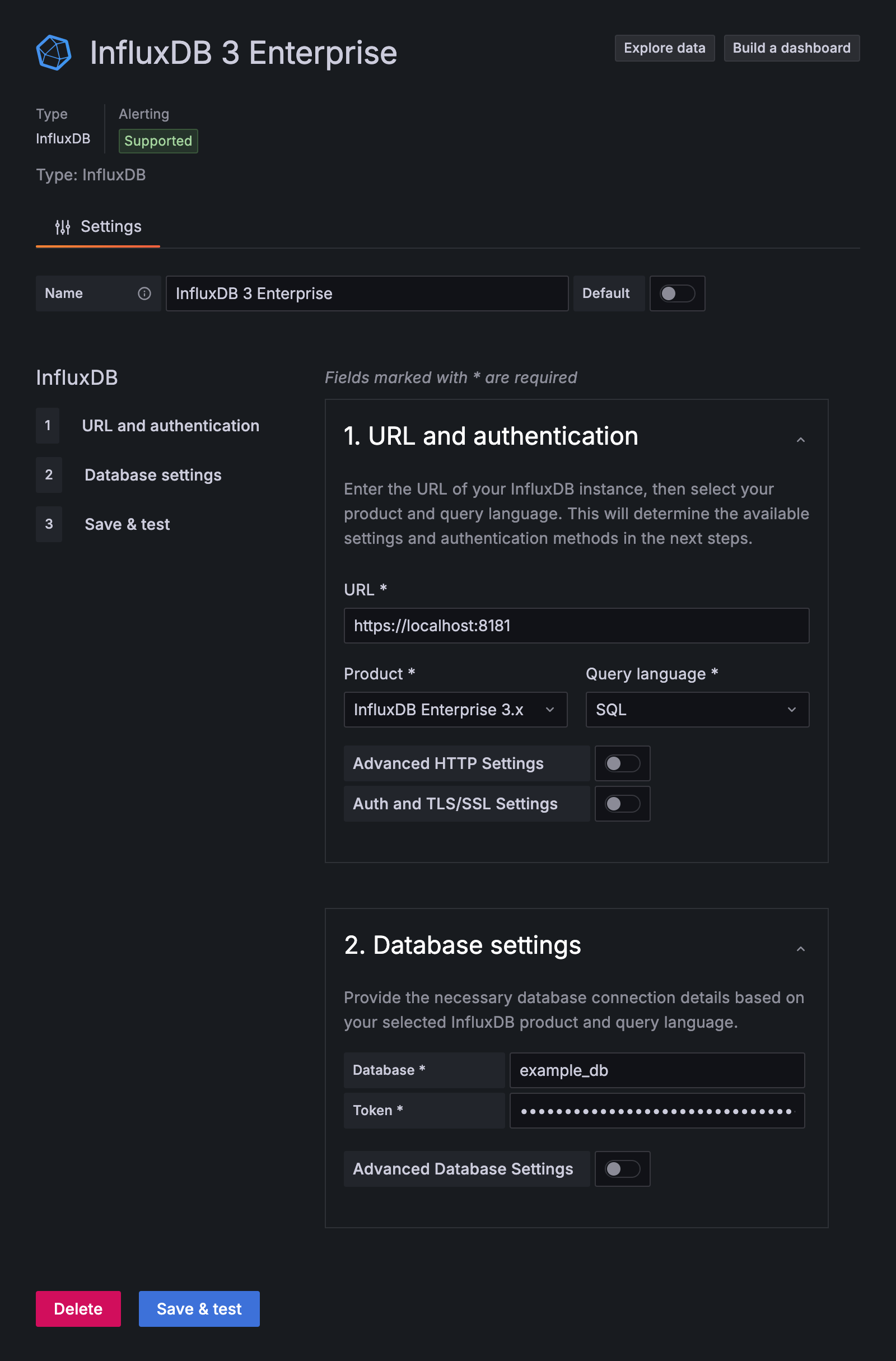

  2. Click Data sources.
  3. Click Add new data source.
  • URL: Your InfluxDB 3 Enterprise
server URL –for example, https://localhost:8181
  • Product: From the dropdown, select
InfluxDB Enterprise 3.x
Configure database settings
SQL configuration
Your admin token with read access to the database

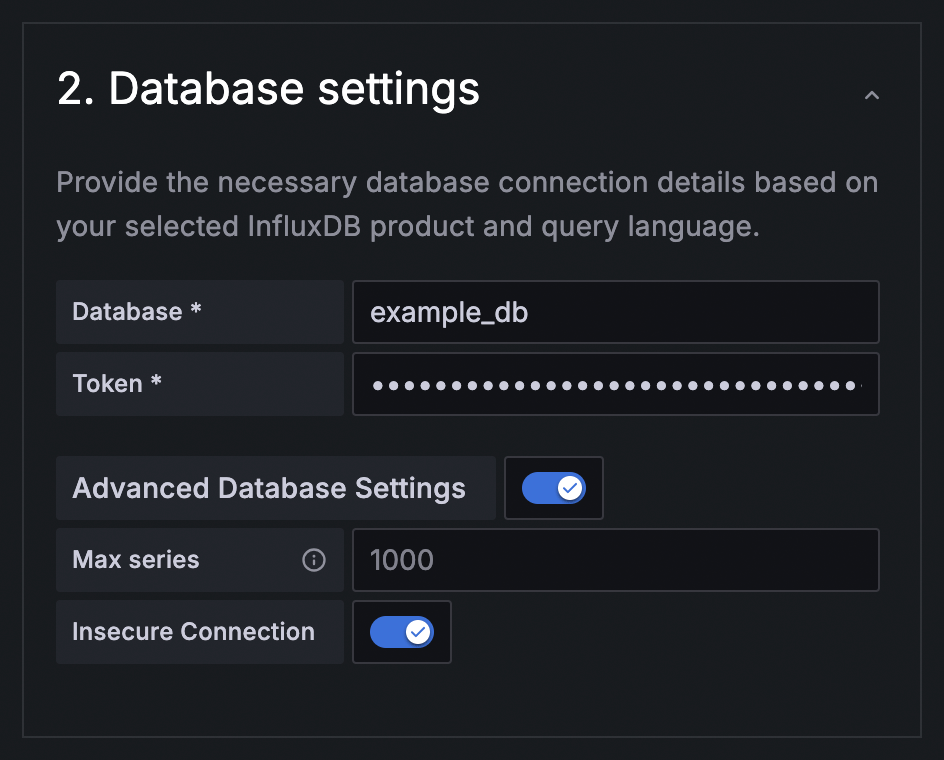

Use SQL without TLS/SSL
If using SQL to query InfluxDB 3 Enterprise without TLS/SSL, enable the Insecure Connection option in your InfluxDB datasource configuration:
  1. Under Database settings, enable Advanced Database Settings.
  2. Enable Insecure Connection.
Query InfluxDB using SQL without TLS/SSL
For SQL queries, Grafana uses the Flight SQL protocol (gRPC) to query InfluxDB 3 Enterprise, which requires HTTP/2. If you query InfluxDB 3 Enterprise through a proxy (such as HAProxy, nginx, or a load balancer), verify that your proxy is configured to support HTTP/2. Without HTTP/2 support, SQL queries through Grafana will fail to connect.
Click Save & test. Grafana attempts to connect to InfluxDB 3 Enterprise and returns the result of the test.

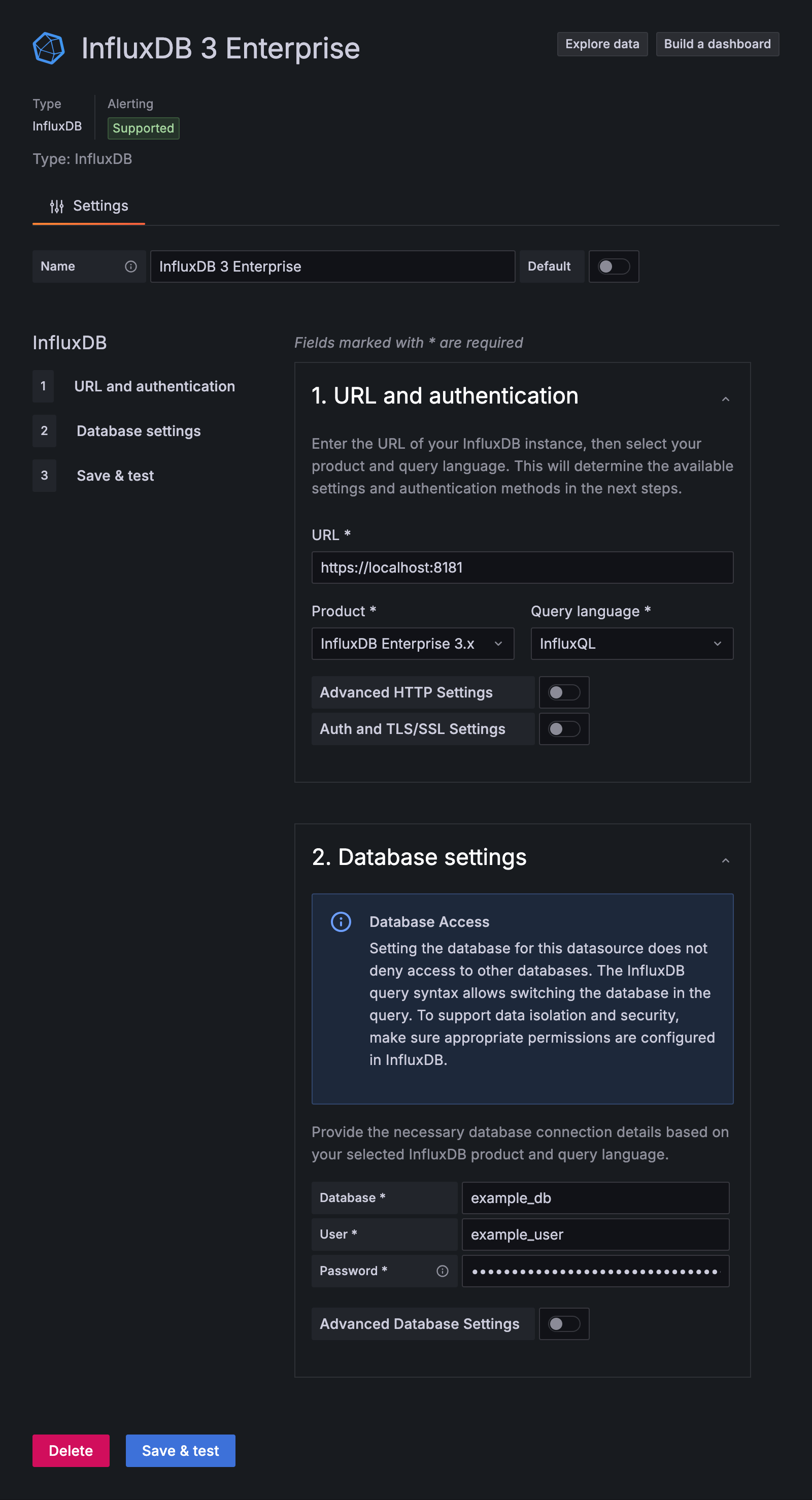

InfluxQL configuration
