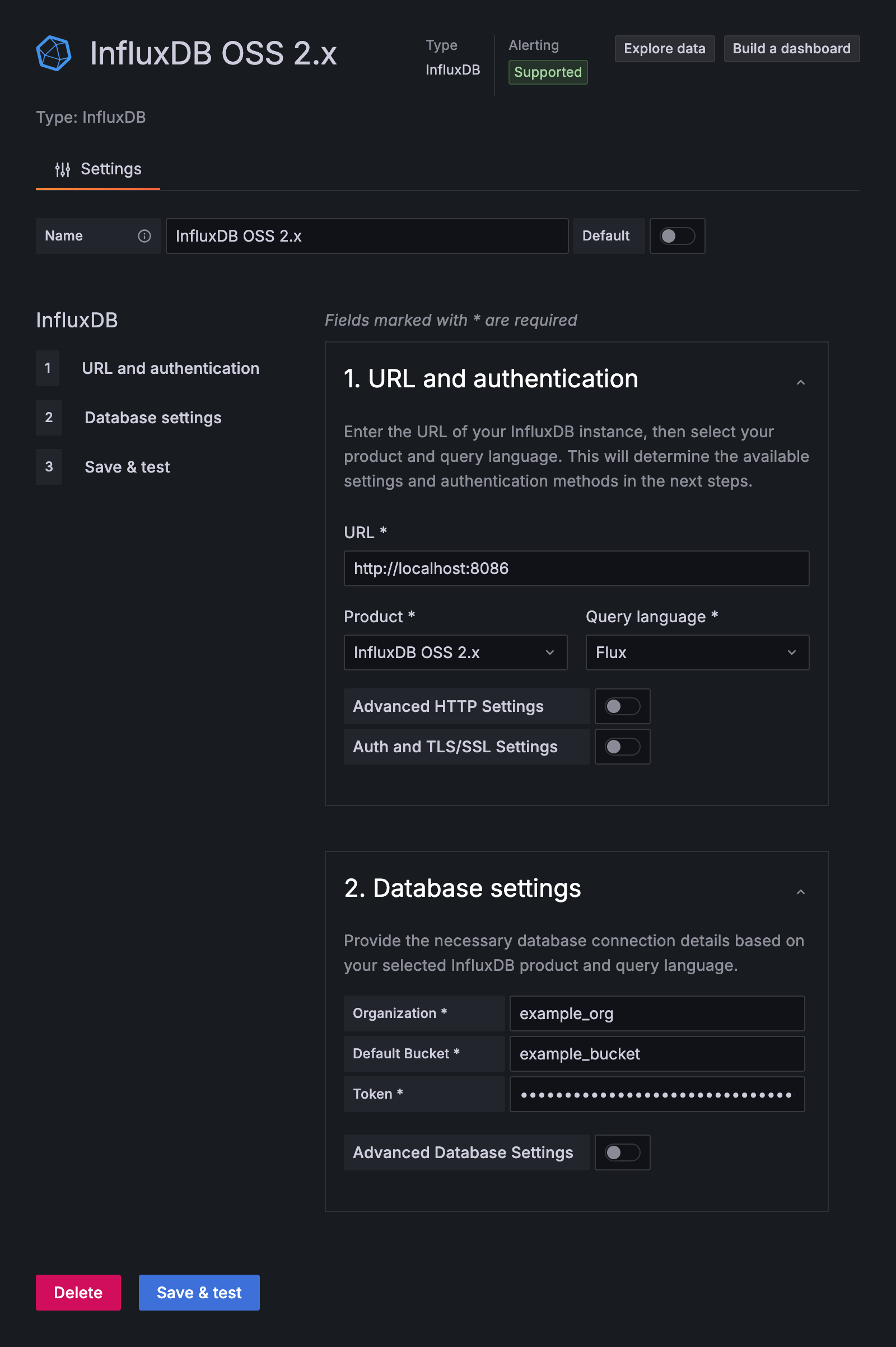

- On the Data Source configuration page, enter a name for your InfluxDB data source.
- Under Query Language, select one of the following:
Configure Grafana to use Flux
With Flux selected as the query language in your InfluxDB data source, configure your InfluxDB connection:
Under HTTP, enter the following:
URL: Your InfluxDB URL.
http://localhost:8086/
Access: Server (default)
Under InfluxDB Details, enter the following:
- Organization: Your InfluxDB organization name or ID.
- Token: Your InfluxDB API token.
- Default Bucket: The default bucket to use in Flux queries.
- Min time interval: The Grafana minimum time interval.
Default is
10s
- Max series: The maximum number of series or tables Grafana will process.
Default is
1000
Click Save & Test. Grafana attempts to connect to the InfluxDB 2.7 datasource and returns the results of the test.

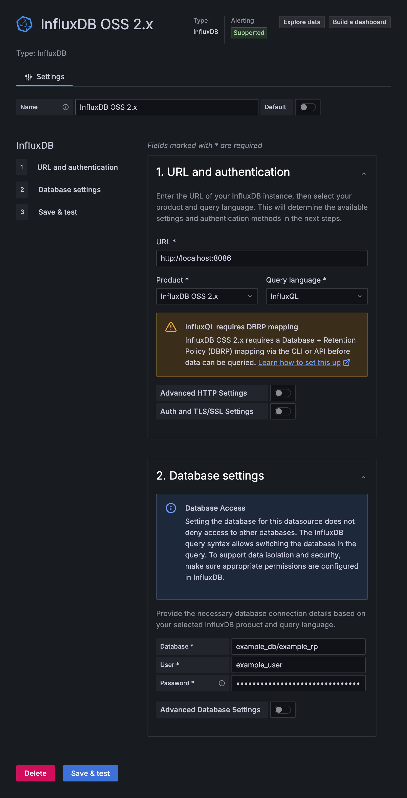

Configure Grafana to use InfluxQL
To query InfluxDB 2.7 with InfluxQL, find your use case below, and then complete the instructions to configure Grafana:
- Installed a new InfluxDB 2.7 instance
- Upgraded from InfluxDB 1.x to 2.7 (following the official upgrade)
- Manually migrated from InfluxDB 1.x to 2.7
Installed a new InfluxDB instance
To configure Grafana to use InfluxQL with a new install of InfluxDB 2.7, do the following:
Upgraded from InfluxDB 1.x to 2.x
To configure Grafana to use InfluxQL when you’ve upgraded from InfluxDB 1.x to InfluxDB 2.7 (following an official upgrade guide):
- Authenticate using the non-admin v1 compatible authentication credentials created during the upgrade process.
- Use the DBRP mappings InfluxDB automatically created in the upgrade process (no action necessary).
Manually migrated from InfluxDB 1.x to 2.x
To configure Grafana to use InfluxQL when you’ve manually migrated from InfluxDB 1.x to InfluxDB 2.7, do the following:
- If your InfluxDB 1.x instance required authentication, create v1 compatible authentication credentials to match your previous 1.x username and password. Otherwise, use InfluxDB v2 token authentication.
- Manually create DBRP mappings.
Configure your InfluxDB connection
With InfluxQL selected as the query language in your InfluxDB data source settings:
Configure InfluxDB authentication:
Token authentication
Under Custom HTTP Headers, select Add Header. Provide your InfluxDB API token:
Header: Enter
Authorization
Value: Use the
Token
schema and provide your InfluxDB API token. For example:Token y0uR5uP3rSecr3tT0k3n
Under InfluxDB Details, do the following:
- Database: Enter the database name mapped to your InfluxDB 2.7 bucket
- HTTP Method: Select GET
Authenticate with username and password
- User: Enter the username associated with your InfluxDB 1.x compatibility authorization
- Password: Enter the password associated with your InfluxDB 1.x compatibility authorization
Click Save & Test. Grafana attempts to connect to the InfluxDB 2.7 data source and returns the results of the test.
